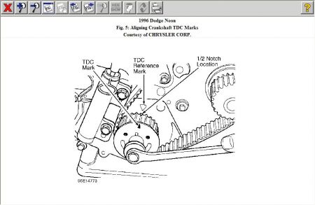

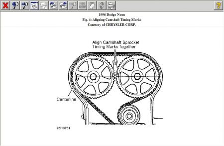

when crank is tdc, cant cam can still be 180 out on mark if no compression ? best way to check is pull valve cover and check valves ? thx

Today is your luck day Okay make sure your no.1 piston is at its TDC compression stroke. Your alignment is below- Camshaft
https://images.2carpros.com/forum/automotive_pictures/12900_T1_1.jpg
Crankshaft
https://images.2carpros.com/forum/automotive_pictures/12900_T2_1.jpg
