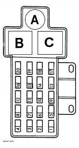

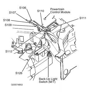

My rear lights and brake lights work but when I put the car in reverse the reverse lights don't come on.

i would check the globe first, then the fuse, No 8. & the switch on the transmission.
