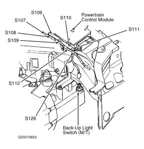

1995 Dodge Neon 4 cyl Two Wheel Drive Manual 130k miles
reverse light always on; car runs great otherwise; on neutral gear cable centered on trx; I mention all this because auto is a trx convert to manual from automatic.

https://images.2carpros.com/forum/automotive_pictures/99387_Graphic1_186.jpg
start with the back up switch unplug it does the light go out if so replace the switch

Reverse light stays on after unplugging back up switch; any suggestion leading to actual repair guarantees gratuity; many thanks

Then u have a short in the wiring system and need to check it
check what else feeding it
was any wiring done have it rechecked
