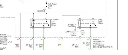

My timing chain was recently changed, it ran good at first. About a couple of days whenever I started it and then put the car in gear, I would step on accelerator and the fuse would blow. I t was the fuel fuse.

Hi, check for applicable trouble codes. You should be able to get some mil codes, by cycling the ignition switch. You turn the key till the dash lites come on, no further. Cycle the key, on--off, on--off, on, then the mil starts flashing, you count the flashes to get the codes. Your looking for two digit codes. The fuel pump fuse supplies voltage to the load/switch side of fuel pump relay, also to the switch and coil side of asd relay, and to the pcm. I'd have to separate the circuits one at a time, try to see what circuit is blowing the fuse.
https://images.2carpros.com/forum/automotive_pictures/170934_dodge_neon_fuel_pump_fuse_1.jpg
