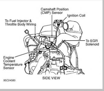

I need to know where this sensor is located so I can repalace it. Now that it is colder out my car wont stay running the first start of the day. I was told to get this sensor, but have no idea of where it goes. Seen many similar, but nothing that will plug into it.

Welcome to the forum, my info showed it is located, driver side rear of cylinder head.
https://images.2carpros.com/forum/automotive_pictures/170934_neon_cts_1.jpg
look at color of wires at wiring connector to be sure. Violet wire with yellow tracer. Tan wire with black or blue tracer. Black wire with red or blue tracer.
