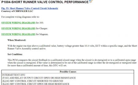

My check engine light came on in my Dodge Magnum. The code I am getting on my scanner is P1004 ECU Battery feed and power grounds, can you tell me what this is I looked in the manual and this code is no where to be found?

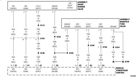

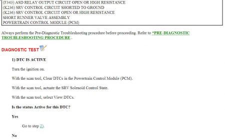

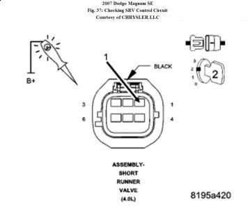

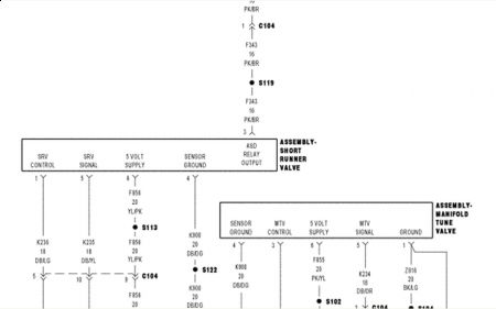

Is this the 3.5 motor? If so, The p1004 code is most likely due to a broken short runner valve in the intake manifold.
