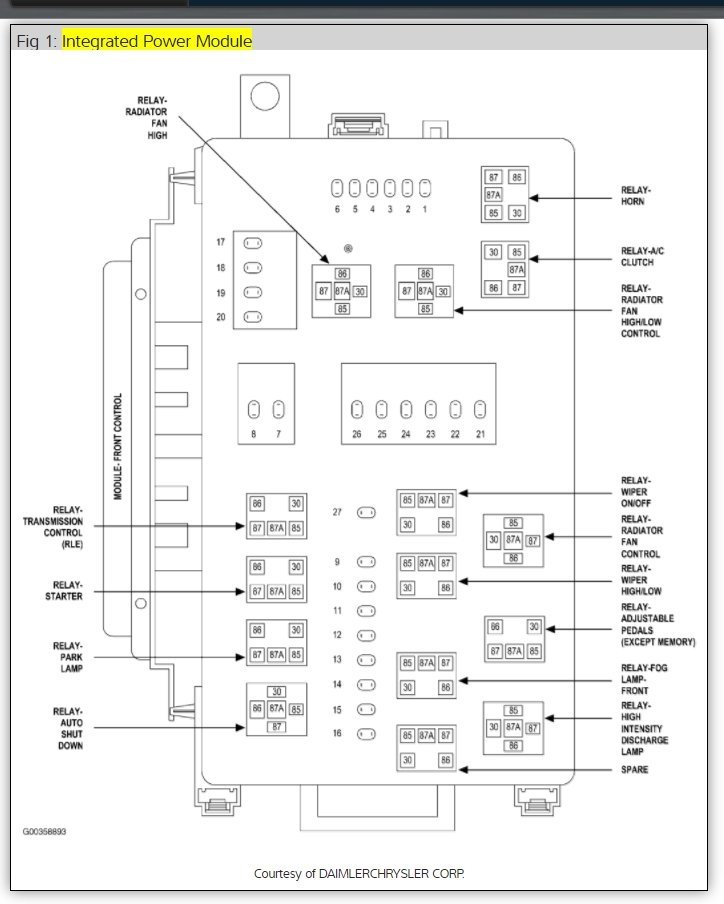

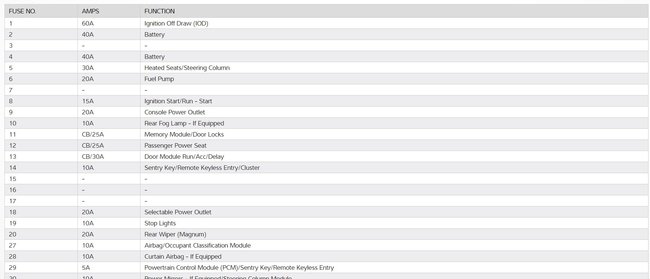

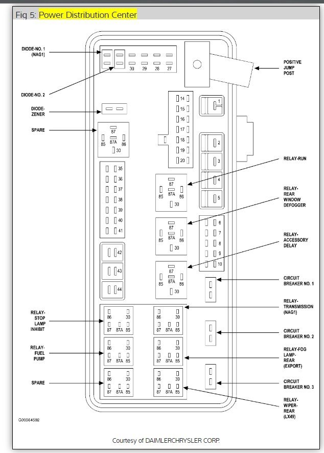

the tail lights will not work all the fuses are good and the bulbs are good, all other lights work in front and rear. The front parking lights are working, The license plate light isn't working. I checked for power on the tail light and plate socket and no power. I removed the panel and found a small group of wires coming from the rear going to the fuse box, should there be a plug?

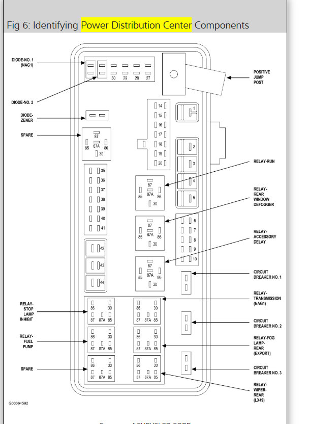

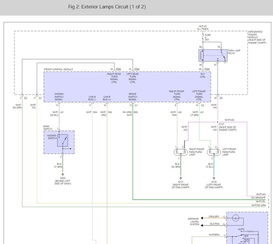

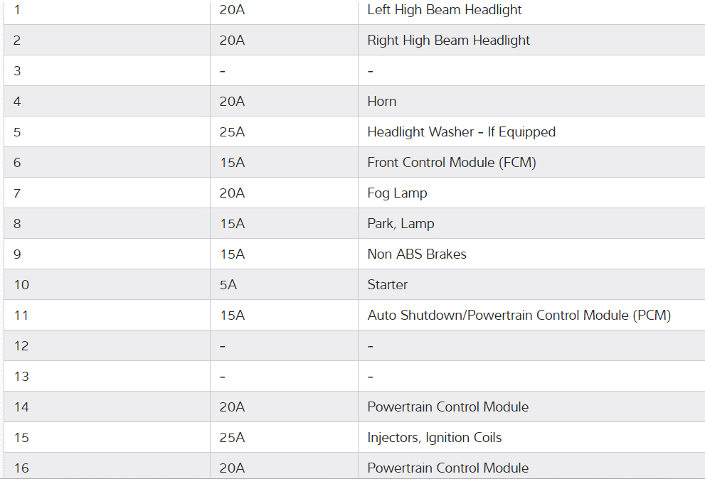

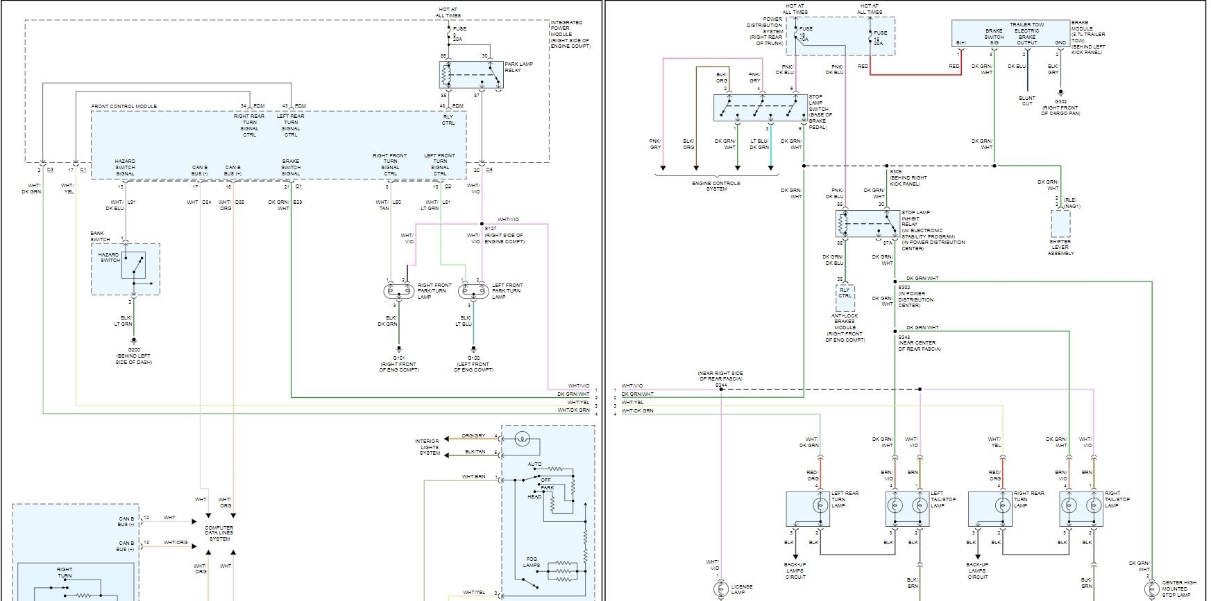

There is a tail light relay that sound like it has gone out, Here are a few guides and the tail light wiring diagrams (below) for you to do some testing and get the problem fixed.
and
Please run some tests and get back to us so we can continue helping you.

What about front?

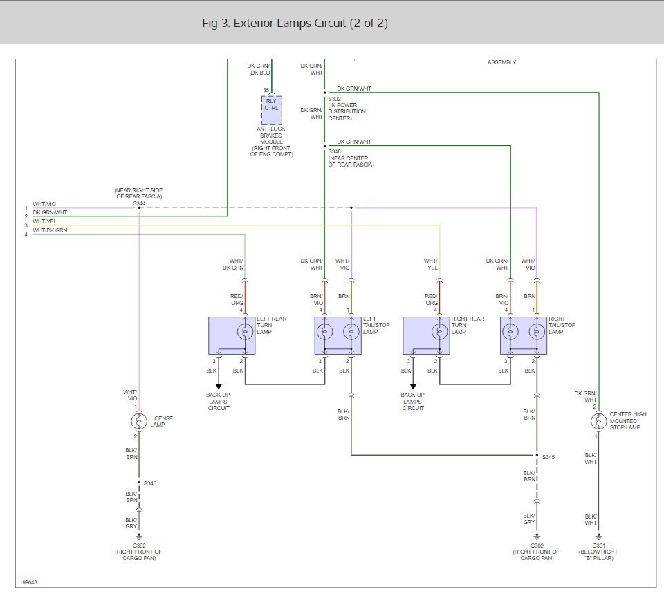

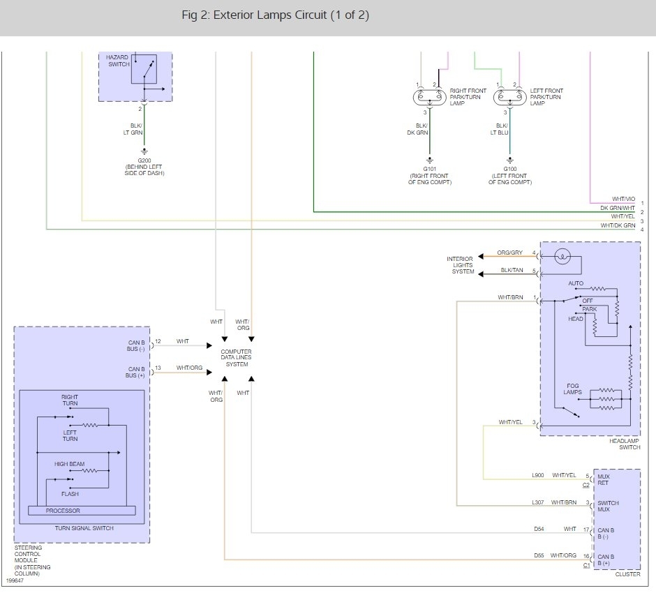

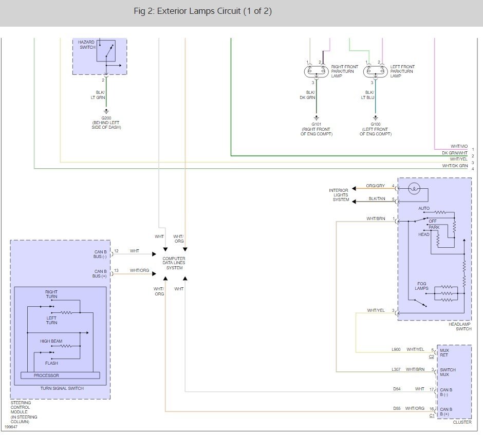

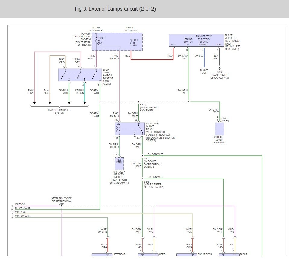

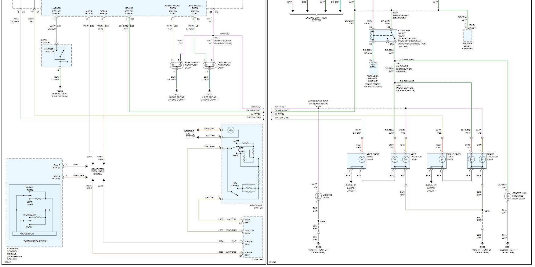

Heres the wiring diagram for the exterior lights for your car

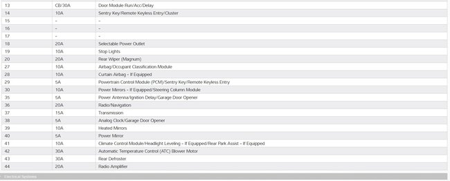

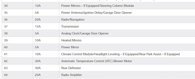

tail light fuse location i need to change it
Dec 14, 2020 at 12:59 AM (Merged)
  • 55,561 POSTS

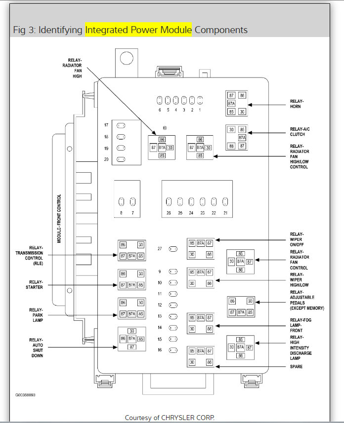

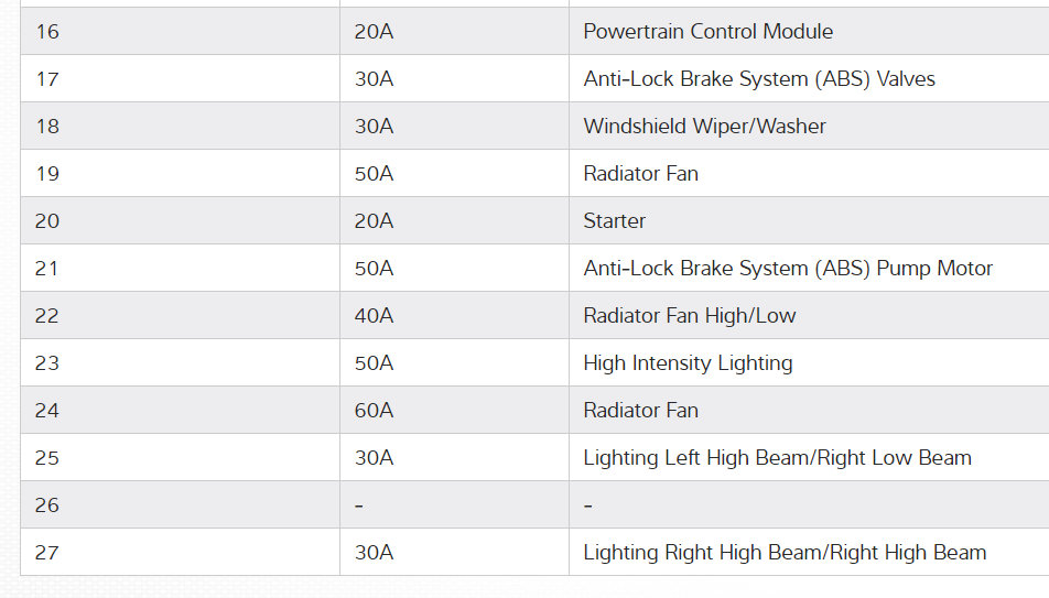

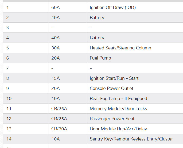

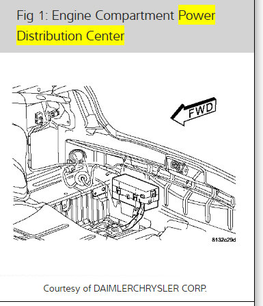

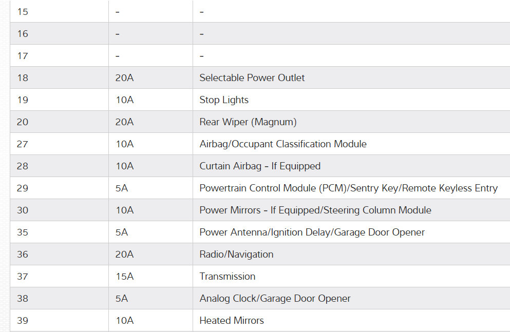

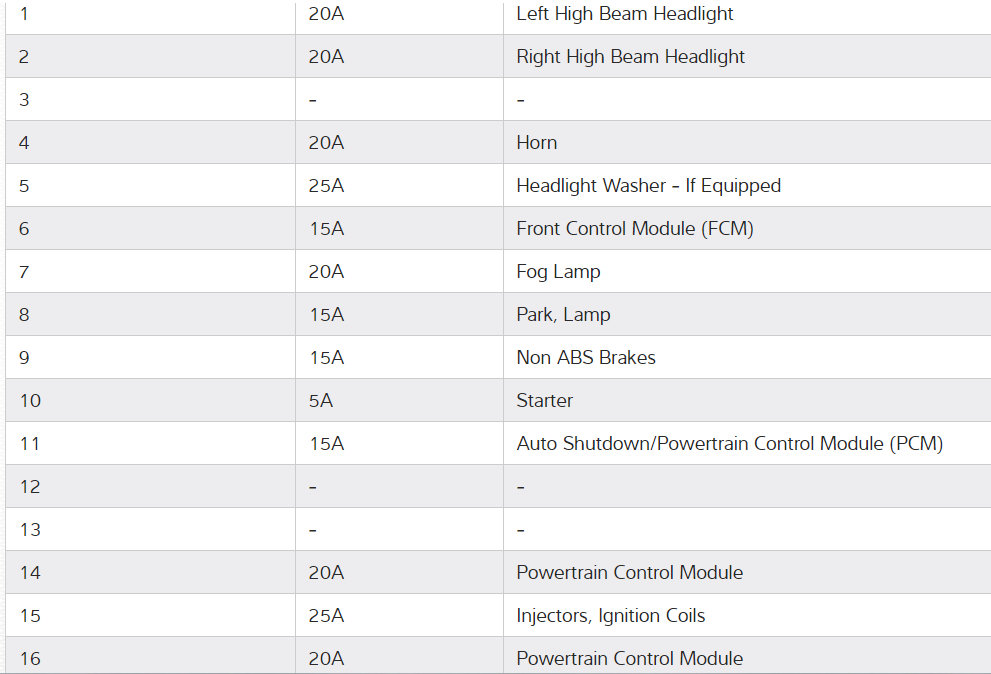

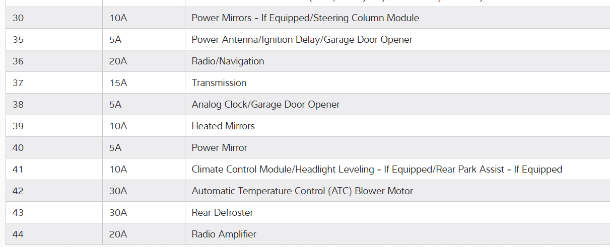

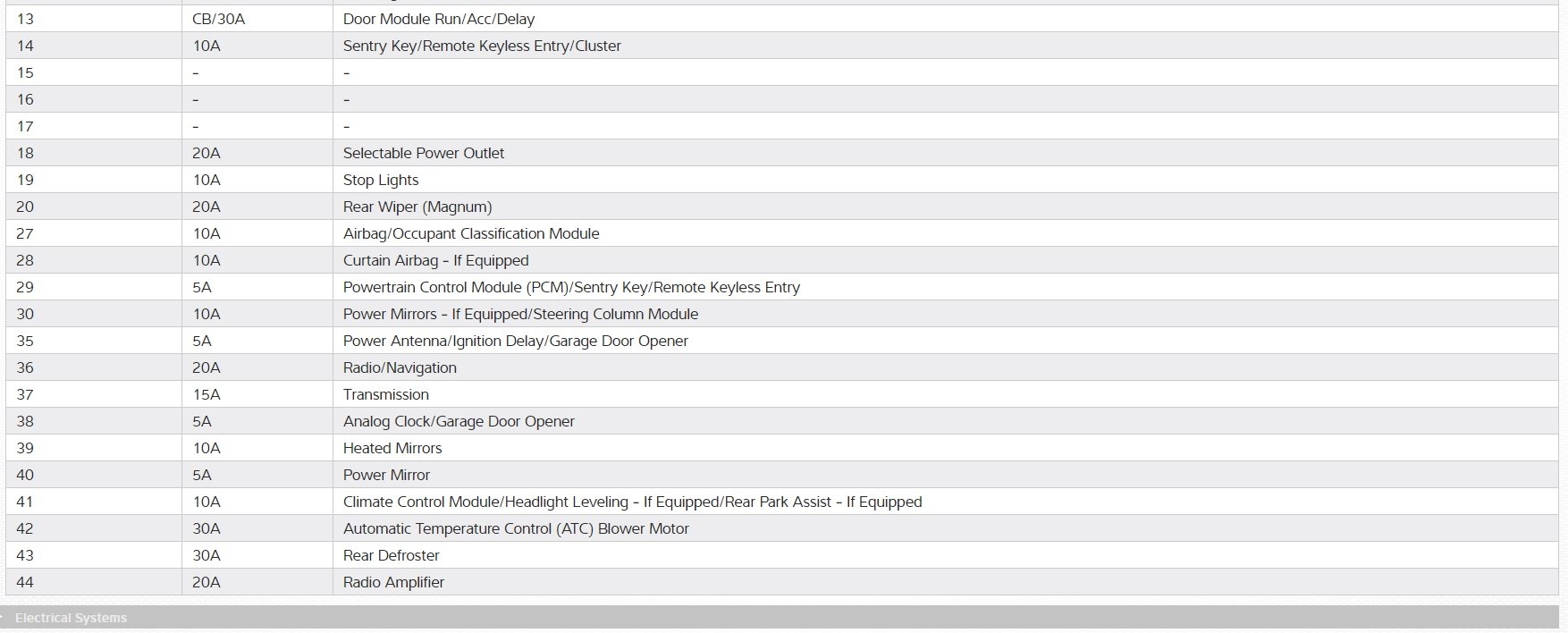

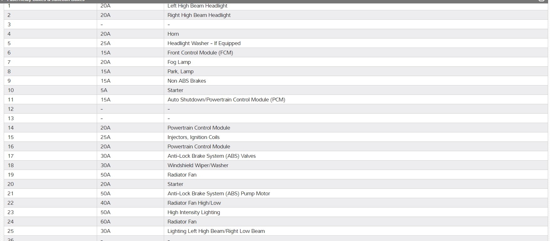

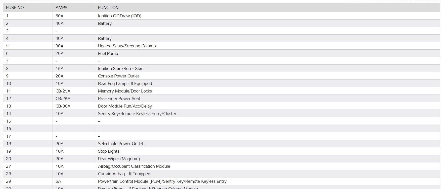

Here is a guide to help you test the fuse with the fuse location in the diagrams below.
