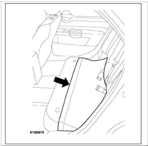

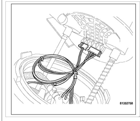

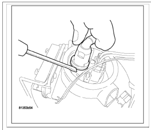

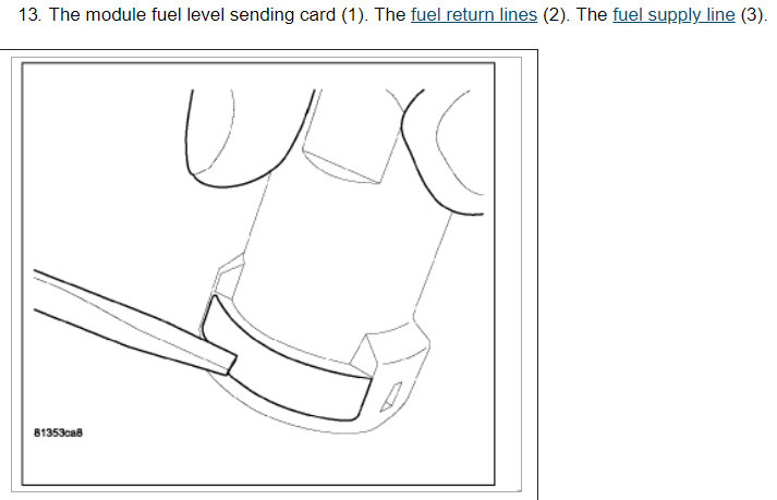

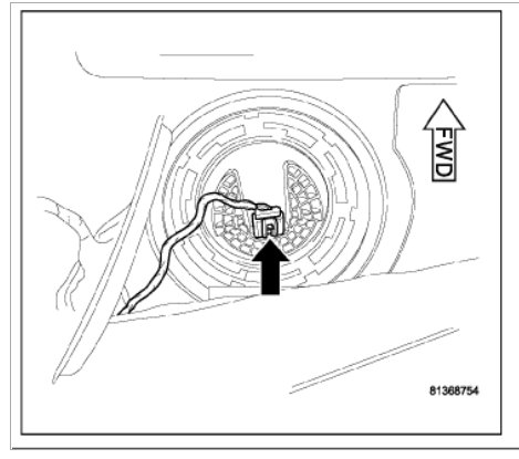

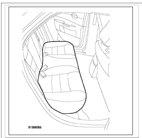

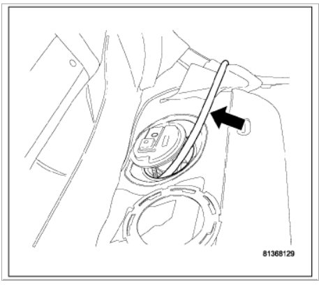

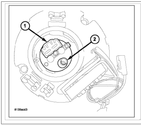

How do you install the fuel pump?
Friday, May 16th, 2008 AT 7:41 PM
THE MAGIC

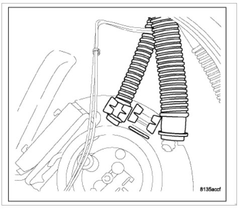

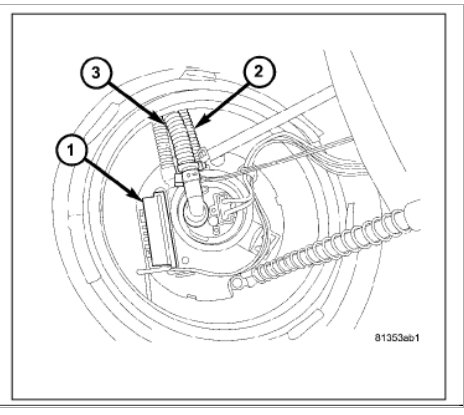

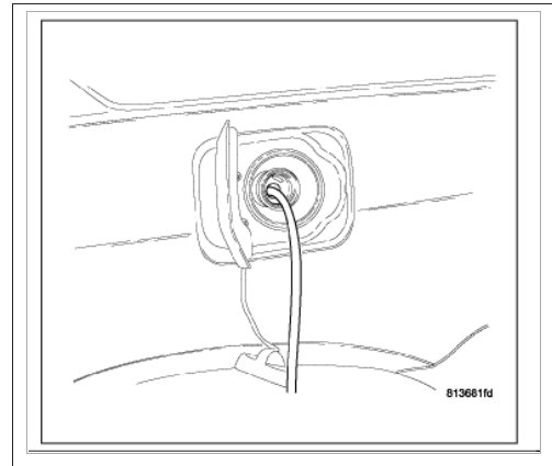

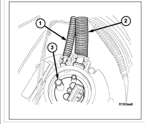

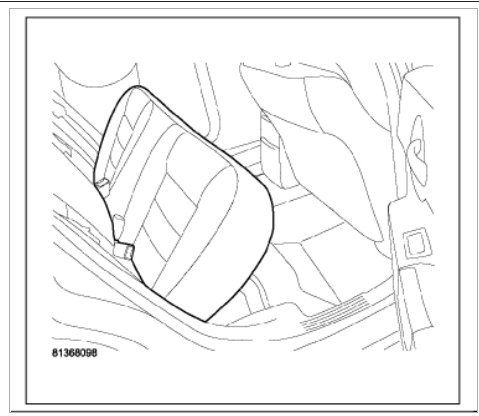

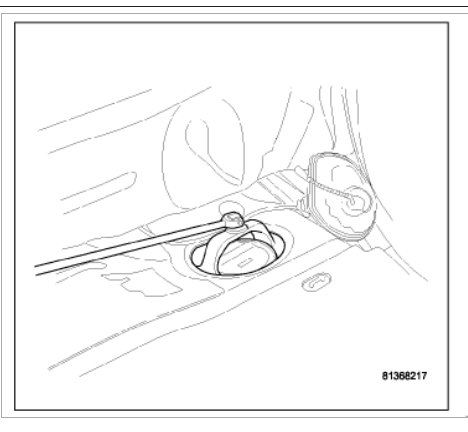

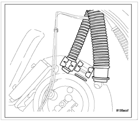

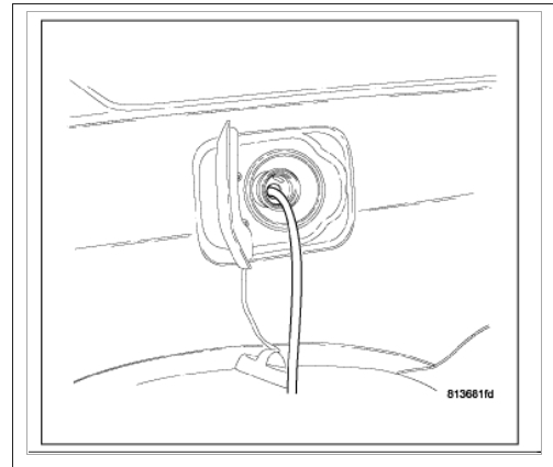

You do not need to drop the furl tank to change the pump out because it is under the rear seat but you will need to drain the gas here is a video showing you how.
https://youtu.be/Q5MH2gnyFH0
Here are diagrams (below) to show you how to remove the fuel pump.
Cheers
