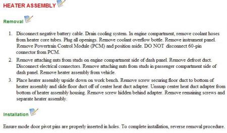

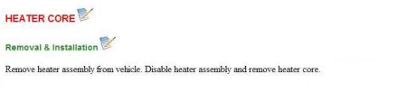

what's the trick to change heater core ,, have taken the glove box out -- can see where it is ,, any helpful hint's would be muchly appericiated

https://images.2carpros.com/forum/automotive_pictures/261618_Noname2_324.jpg
https://images.2carpros.com/forum/automotive_pictures/261618_Noname_1133.jpg
