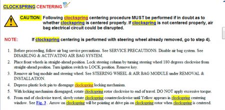

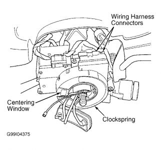

Hello I own a 1999 Dodge Intrepid ES with 170k miles on a 3.2L and I have a question about the name of a part. The part that needs replaced is the piece that sits behind the steering wheel and connects the horn, airbag, and the cruise controll. The flat cable has been broken away from the connection point. What is the name of that part? I have some numbers but im not sure if they are good, P04698304 and 3rh0588e. I uploaded a photo I hope that helps. Thanks[img:9e0175cb30]http://www.2carpros.com/forum/automotive_pictures/100450_DSC009691_1.jpg[/img:9e0175cb30][img:9e0175cb30]http://www.2carpros.com/forum/automotive_pictures/100450_DSC009711_1.jpg[/img:9e0175cb30]

What you are holding is the Clockspring! Here's the centering proceedure.
https://images.2carpros.com/forum/automotive_pictures/62217_ClockCenter_copy_1.jpg
https://images.2carpros.com/forum/automotive_pictures/62217_Clockspring_1.jpg
