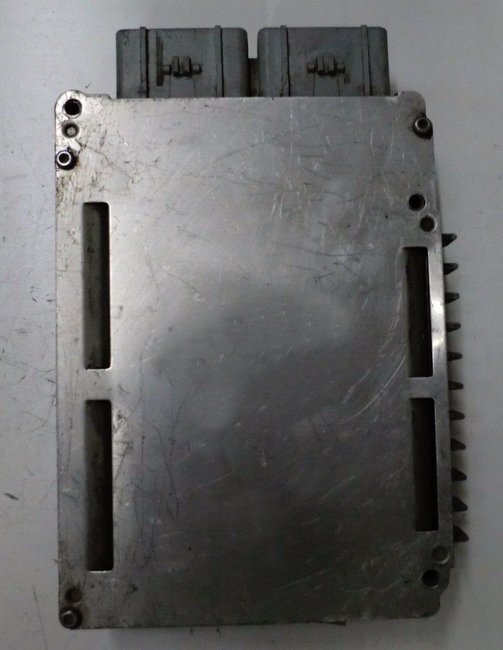

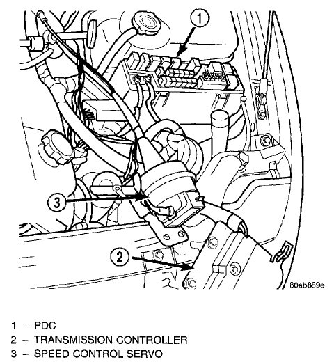

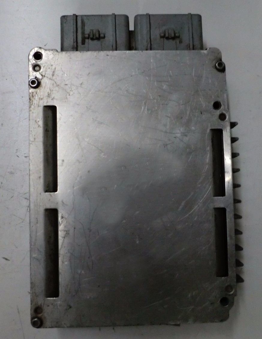

Where is the PCM located in my car?
Aug 28, 2017 at 9:18 AM
STEVE W.
  • 15,295 POSTS
It is under the hood in front of the washer bottle. The transmission control module is attached to it. Do you have a DRB or equivalent scan tool to be able to program the new unit if you replace it? If not the car will not start as you need to program the SKIM and VIN into the replacement.
