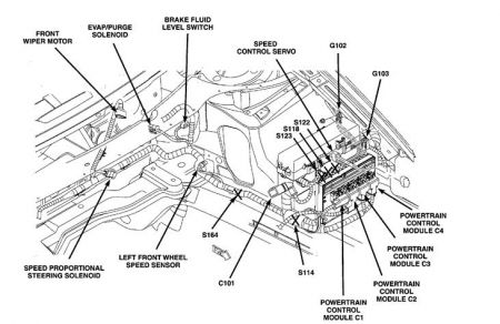

My wipers do not work at all. I purchased a new wiper motor and am tyring to replace it, but cannot locate the old one. Where is it located at?
Jan 30, 2010 at 2:21 AM
BLUELIGHTNIN6
  • 16,542 POSTS
front wiper motor is located on left side of firewall, under tower to tower (crossbar) support.
