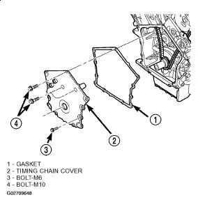

have everything removed from cover do the two big bolts in middle of cover need removed or should cover pop off

Yes M10 bolts need to be removed see diagram

How do you remove the M10 bolts from the cover? I've tried everything even broke sockets doing this . Is there something special I need to remove these?

No special tools they are tighten to 40 ft. lbs so should come out. Do you have a six point 1/2 drive socket ?

I have these but it still didn't work. They are so tight on there, I can't get them off. I've broken sockets trying to get them off. Any other ideas I can use?
