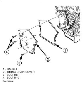

have everything removed from cover do the two big bolts in middle of cover need removed or should cover pop off
Feb 16, 2010 at 12:53 AM
DOCFIXIT
  • 18,828 POSTS
Yes M10 bolts need to be removed see diagram
https://images.2carpros.com/forum/automotive_pictures/198357_Graphic_357.jpg

How do you remove the M10 bolts from the cover? I've tried everything even broke sockets doing this . Is there something special I need to remove these?
Feb 16, 2010 at 3:01 AM
DOCFIXIT
  • 18,828 POSTS
No special tools they are tighten to 40 ft. lbs so should come out. Do you have a six point 1/2 drive socket ?
Feb 16, 2010 at 3:09 AM
STEELERRAM
I have these but it still didn't work. They are so tight on there, I can't get them off. I've broken sockets trying to get them off. Any other ideas I can use?
