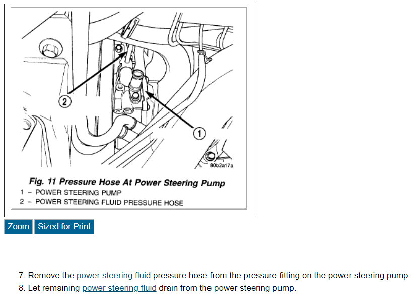

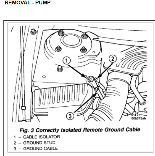

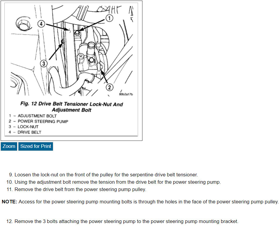

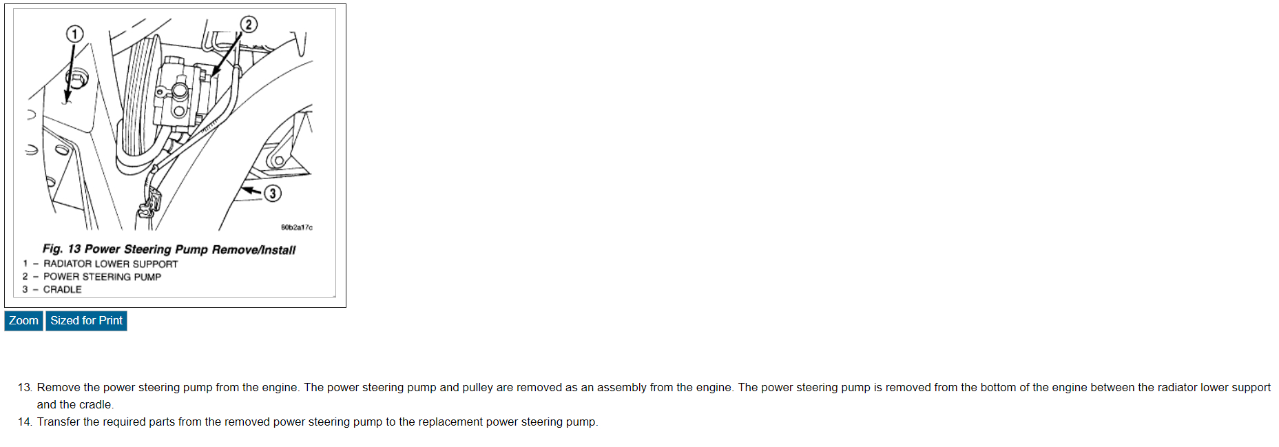

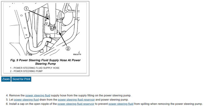

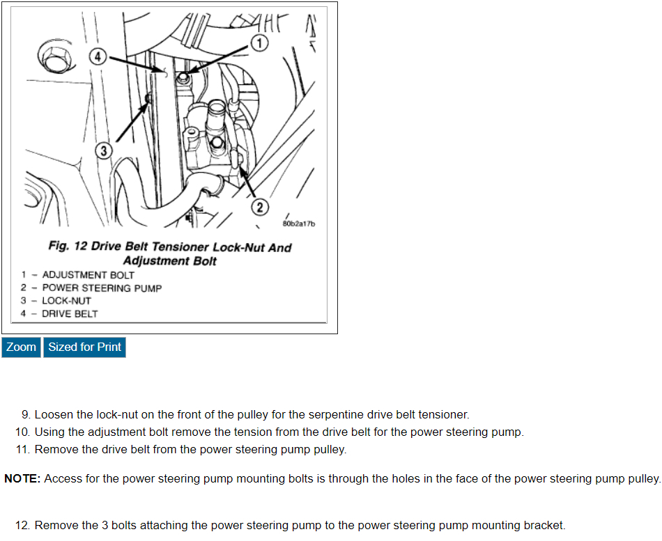

Constant whining sound , almost positive it's the power steering pump. Looks like a pretty tight fit with bruised knuckles but I've done it before , just not on this car. Need some advice on best way to approach it.
Jun 1, 2010 at 7:55 PM
BLUELIGHTNIN6
  • 16,542 POSTS
I have a guide on what you are in for when doing the job and diagrams to help you see what it will be like for your car below.
https://www.2carpros.com/articles/how-to-replace-a-power-steering-pump
and
https://youtu.be/MtHG4y_rdMI

Thank you ! This site is great :) job done and back on the road.
