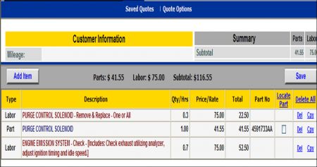

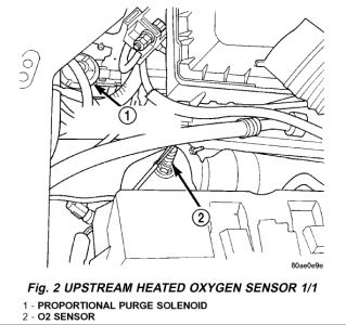

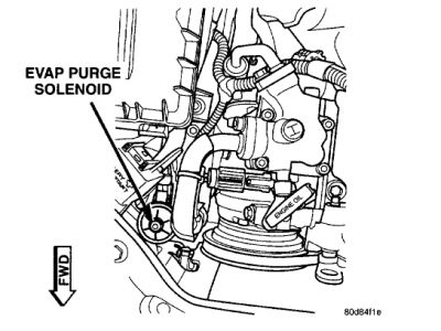

Hello - lilday50 Okay........there we go.......... Well, based off of the code it is the proportional purge solenoid. Now you are supposed to do some checks of the system with a scanner to make sure that is the problem. I just kind of followed the troubleshooting tree to see where it would take me. I have attached a few things for you. The item location, a couple of pics of that. What it is and what it does. The actual troubleshooting chart information The removal and installation if you or someone can do that. An estimate of a shop doing it. The shop estimate is again, an estimate. Could be a little more or less but that is ball park. Also remember, without test equipment I am only giving you a best guess.....but this should get you in the area. Hope that helps. Description and Operation Notes DESCRIPTION All vehicles use a proportional purge solenoid. The solenoid regulates the rate of vapor flow from the EVAP canister to the throttle body. The PCM operates the solenoid. OPERATION During the cold start warm-up period and the hot start time delay, the PCM does not energize the solenoid. When de-energized, no vapors are purged.
https://images.2carpros.com/forum/automotive_pictures/248015_101729289_1.jpg
The proportional purge solenoid operates at a frequency of 200 hz and is controlled by an engine controller circuit that senses the current being applied to the proportional purge solenoid and then adjusts that current to achieve the desired purge flow. The proportional purge solenoid controls the purge rate of fuel vapors from the vapor canister and fuel tank to the engine intake manifold.
https://images.2carpros.com/forum/automotive_pictures/248015_4_35.jpg

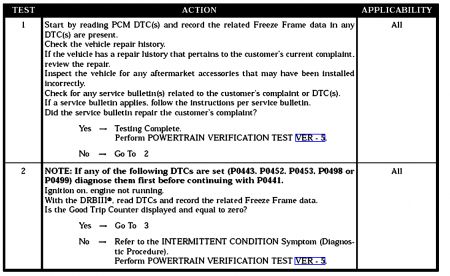

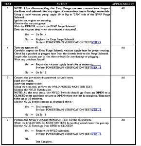

SYMPTOM P0441-EVAP PURGE SYSTEM PERFORMANCE WHEN MONITORED Cold start test. Engine Running. Small leak test passed.. SET CONDITION The PCM activates the EVAP Purge solenoid gradually increases to maximum flow. During flow, the PCM looks for the NVLD switch to close. If the PCM does not see the NVLD switch close at maximom flow an errow is detected. Two Trip Fault. POSSIBLE CAUSES Good Trip Equal to Zero NVLD Switch Operation Vehicle History and Service Bulletin Investigation Checking EVAP Purge Solenoid Functionality EVAP Purge Vacuum Supply Verify NVLD Operation REMOVAL
https://images.2carpros.com/forum/automotive_pictures/248015_3_58.jpg
The solenoid attaches to a bracket near the air cleaner. The solenoid will not operate unless it is installed correctly. Disconnect electrical connector from solenoid. Disconnect vacuum tubes from solenoid. Remove solenoid from bracket. INSTALLATION The solenoid attaches to a bracket near the air cleaner. The solenoid will not operate unless it is installed correctly. The top of the solenoid has TOP printed on it. The solenoid will not operate unless it is installed correctly. Install solenoid on bracket. Connect vacuum tube to solenoid. Connect electrical connector to solenoid.
https://images.2carpros.com/forum/automotive_pictures/248015_Picture1_38.jpg
