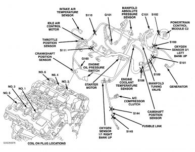

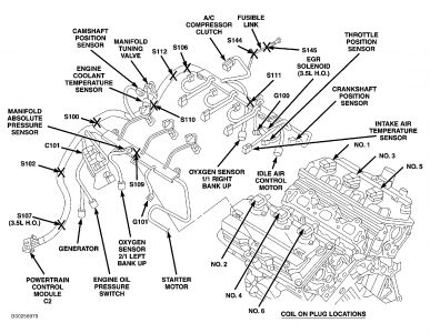

My light activates below 1800 RPM. I changed the oil and filter. Where is the pressure sensor located? Above the engine or near the filter? Should I also replace the harness as well when I replace the sensor? I read on another site that it should be replaced too.
I can't locate any online schematics to assist me in locating this sensor.
Nov 19, 2008 at 1:27 AM
ZACKMAN
  • 4,202 POSTS
If it is 2.7L it is on the right side of the engine
https://images.2carpros.com/forum/automotive_pictures/55316_27oilpressure_1.jpg
if it is 3.5L it is on the left side of the engine
https://images.2carpros.com/forum/automotive_pictures/55316_35oilpressure_1.jpg
