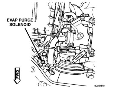

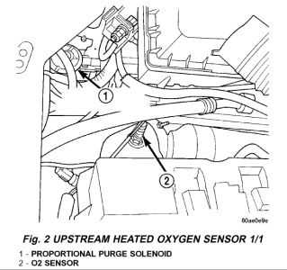

one last question,,, where can I find a diagram or pictures of the component for the evap for Dodge Intrepid 04
thanks
Nov 9, 2009 at 10:20 AM
MATHIASO
  • 1,209 POSTS
Hello roque71 I have something here that can help.
https://images.2carpros.com/forum/automotive_pictures/46384_purge_solenoid_1.jpg
follow hose connected to the solenoid, it will lead you to the canister.
https://images.2carpros.com/forum/automotive_pictures/46384_solenoid_1.jpg

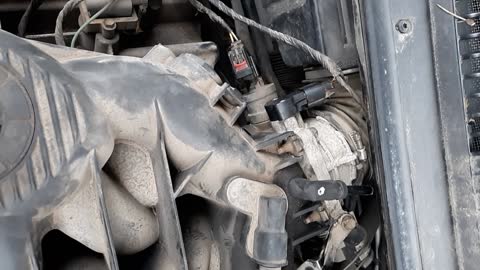

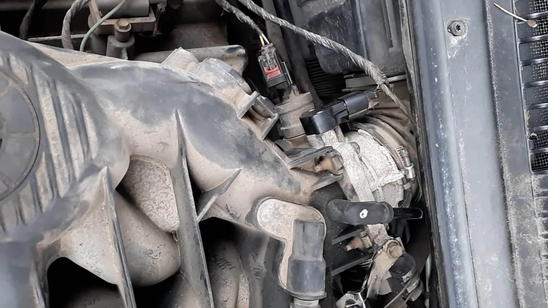

So I need help I dont know what to do to figure this out any further I know a little when it comes to cars but I try to stay away from shops if I can do things myself they r just too expensive. I have changed the map sensor and tps sensor it has been running good but I've had a engine code on for bout a month and a half saying small evap leak so i thought it was no big deal. The other morning i went to start it and it wasn't even drivable I am posting a video of what it was doing I let it run for a minute or so like this to try and look things over to see what the deal was I really wasnt sure so I turned it off went back inside Googled some things went back out and started it up and it was completely fine. What the hell can anyone please help and tell me how this is and what it is I'd really appreciate it

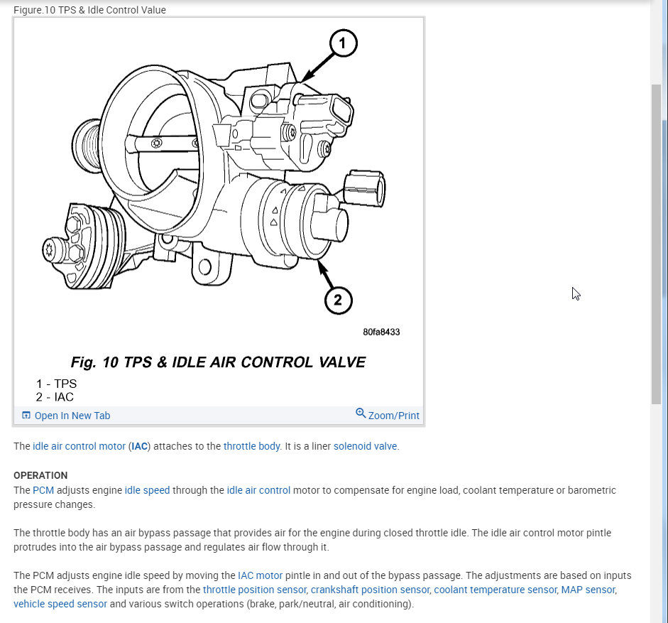

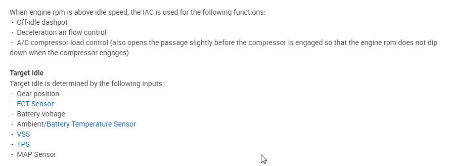

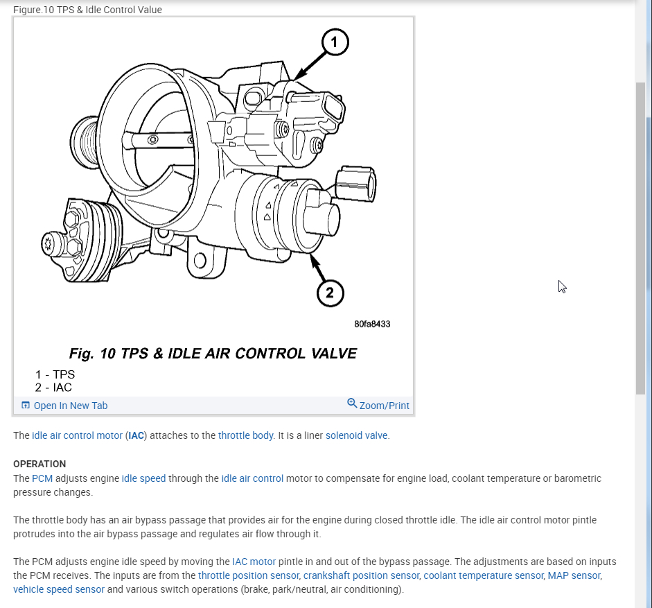

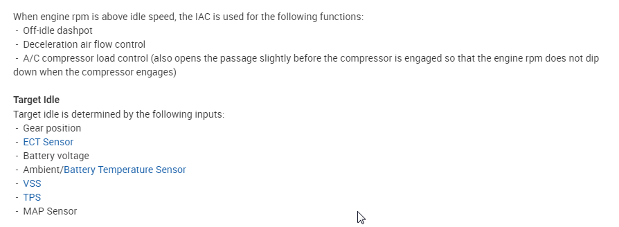

Couple things. Check to see if the check engine light has any other codes. If this happened one time it may be hard to figure out without any codes. Next, this surging is normally idle control so I am wondering if the throttle blade was stuck or binding. When you replaced the TPS did you clean the throttle bore?
After that we need to check for a vacuum leak. However this is unlikely if it ran fine a couple minutes later.
Let's start with what codes are in the PCM and a throttle service and go from there. Thanks

I had two codes come up when it started doing that weird deal in the video I uploaded.
p0068 MAP/MAF throttle position correlation
p0121 throttle/pedal position correlation/switch A circuit range / performance
It also slightly pauses kind of weird on the take off now only when I stop and give it gas to go again just a little mild pause if that makes any sense. I'm hoping this will help to maybe give me something solid otherwise I'm about to clean the throttle bore as you suggested this weekend and then not to sure where to really go from there. Also when it first starting running like that in the video I smelled a gas odor pretty bad at first. if that helps with anything. also please let me know if you can further help me I appreciate it.

Okay. Let's get a new post started with this information. We need to keep this to one issue per post because others won't find this issue under an EVAP heading and this is not an EVAP issue. Your issues are related to the codes so we need to fix those. Post a new question and I will look for it and send you the tests for it. Thanks
