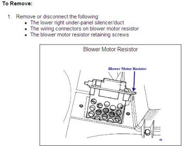

how to replace it i see it under the right floor but what do u have to do to get to it
