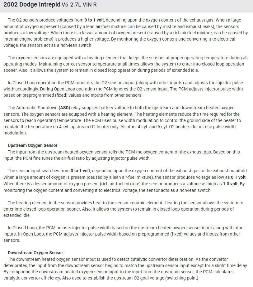

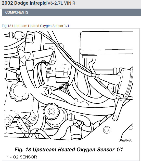

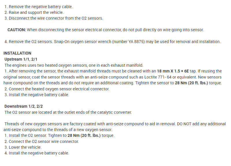

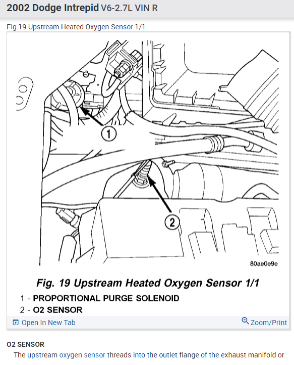

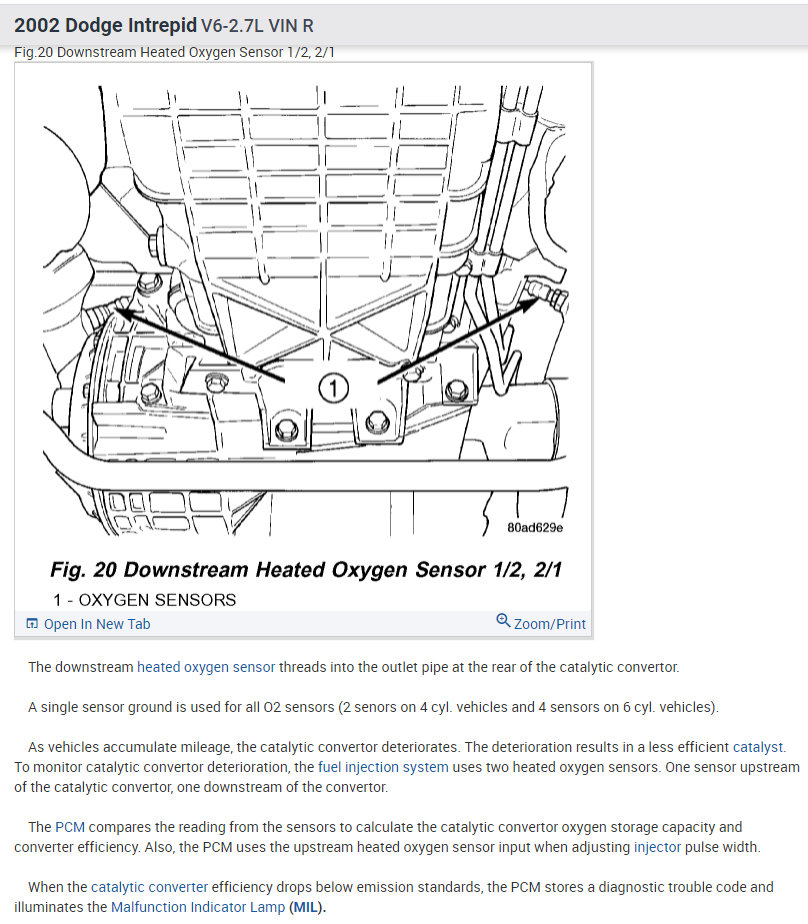

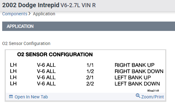

Which side of the engine is bank 1; the driver's or passenger side? I need to replace it.
Aug 25, 2008 at 4:07 AM
SQM
  • 6,383 POSTS

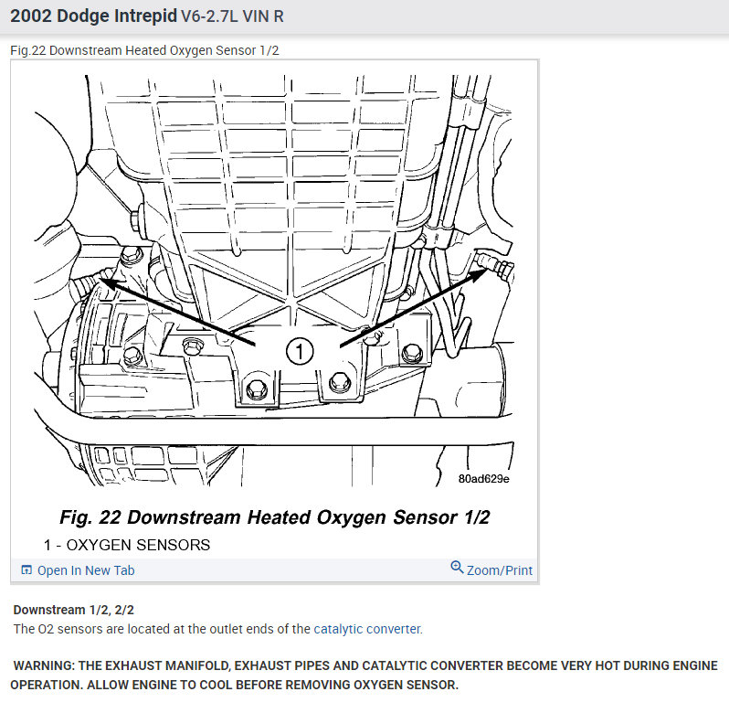

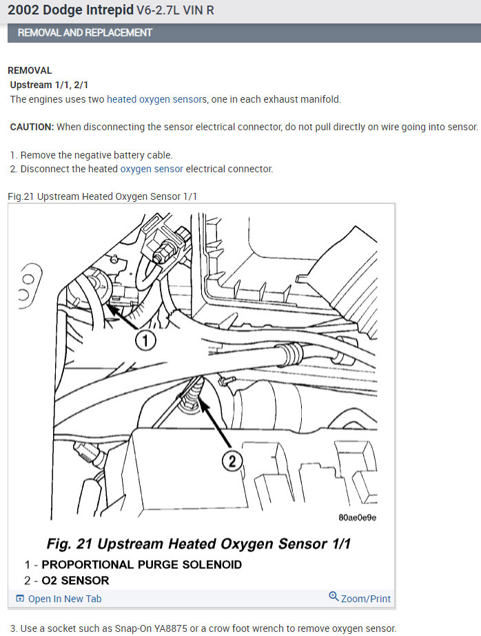

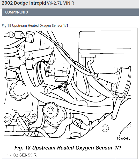

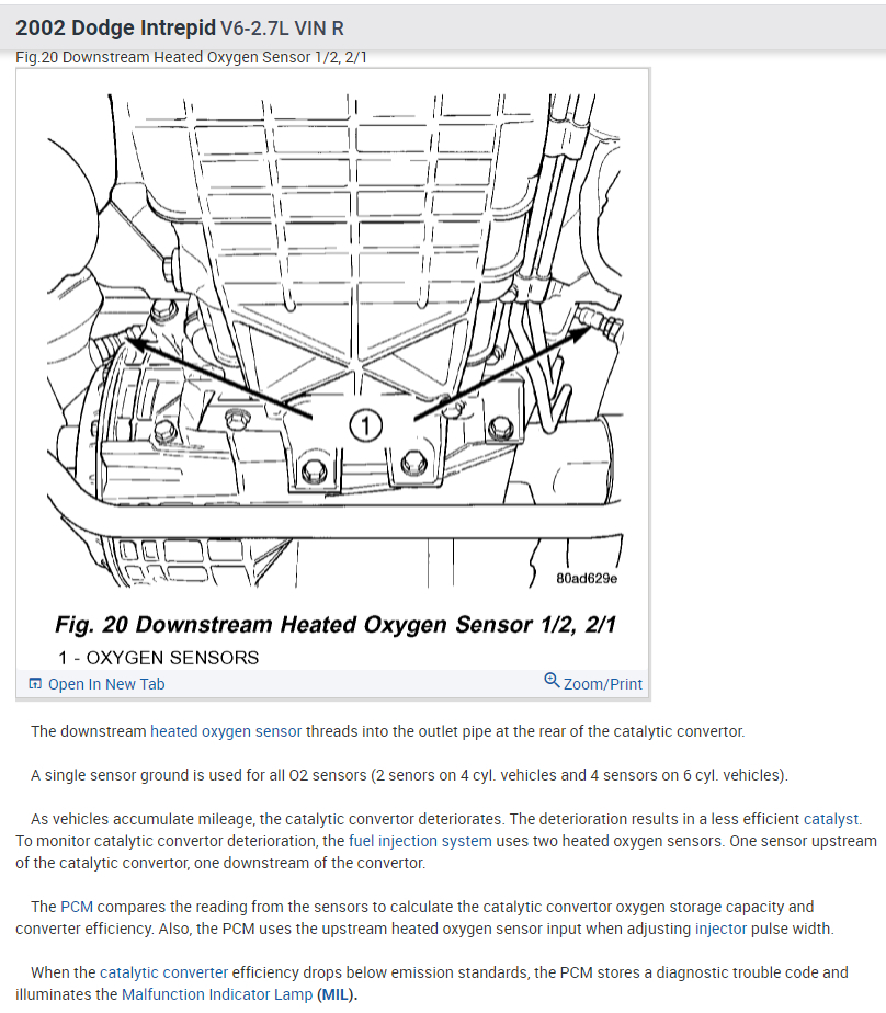

The right side is the bank 1. The one before the catalytic converter is the sensor 1 (upstream) and the one after the catalytic converter is the sensor 2 (down stream).
The upstream sensor is located on the exhaust manifold and down stream sensor is in the exhaust pipe after the catalytic converter.
