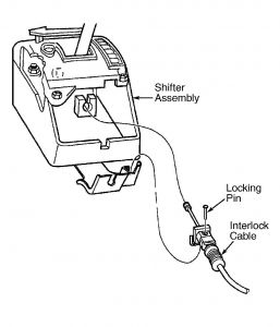

ok check the shifter interlock cable here what it look like and where good luck
https://images.2carpros.com/forum/automotive_pictures/99387_02_dodge_intre_1.jpg
LET ME KNOW
Feb 12, 2008 at 10:11 AM
PEEDEE
  • 5 POSTS
this looks like a floor shift , mines a column
shift, or else iam not looking at it right

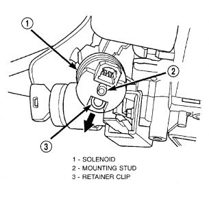

You have a shifter solenoid its located by the ignition cylinder check for power when brake applyed
https://images.2carpros.com/forum/automotive_pictures/99387_02_dodge_intre_2.jpg
Feb 12, 2008 at 1:42 PM
PEEDEE
  • 5 POSTS
The brake lock solenoid was dirty and spraying wd40 allowed the solenoid to operate. Thanks for your help.
