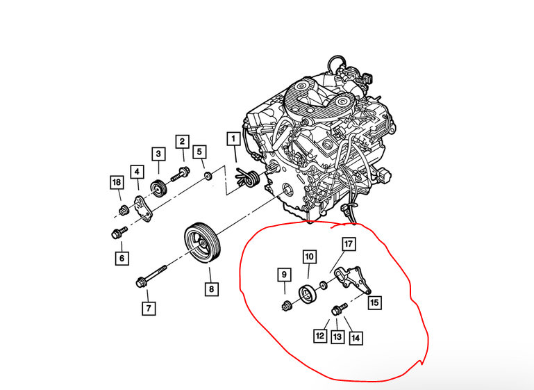

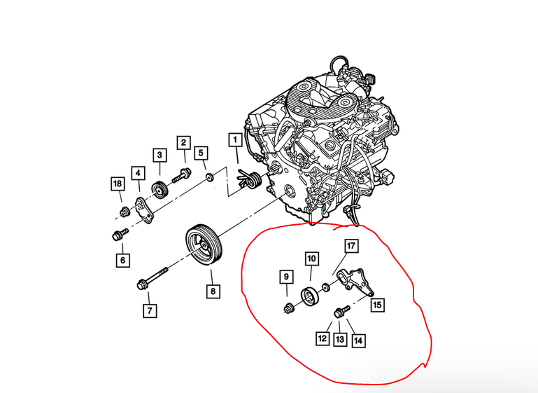

spacer or a spring on or behind the pulley to keep it from moving or wiggling
2002 DODGE INTREPID
100,117 MILES • 4 CYL • 2WD • AUTOMATIC
KAM_MAISON
i have a 2002 dodge intrepid that just recently had a bushing go bad in the idler pulley... i bought a new pulley and a new belt. but after i put them on and tightened the belt the pulley wiggles around still. so my question is .. is there supposed to be a spacer or a spring on or behind the pulley to keep it from moving or wiggling? i have been looking and asking people and noone seems to know. not even the DODGE DEALERSHIPS!!!!!
Nov 9, 2008 at 6:34 PM
SQM
  • 6,383 POSTS
There is a spaced that goes behind the idler pulley as it gets mounted to the bracket.
You should be able to reuse the spacer when you took off the old pulley.
Without it the pulley will not align properly, and the bell can come off
https://www.2carpros.com/articles/how-a-serpentine-belt-works
I have attached a diagram for your reference.
