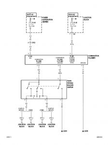

DEAR SIRS; MY SINALS DON'T WORK. SOMETIMES THEY DO, BUT NOT REALLY. I ALREADY CHANGED BULBS AND FUSES.

Is this a problem on all turn signal lamps on the car or just some? Do the problem lamps flash rapidly or not at all (or do they differ)?

THEY DON'T FLASH AT ALL.

Do they come on steady with the lights on? If so then the turn signal switch in your steering column needs to be replaced. This is the wiring schematic for the turn signals. This should be the correct one but let me know if there are any discrepancies.
https://www.2carpros.com/forum/automotive_pictures/187088_0900c1528003f686_1.jpg
