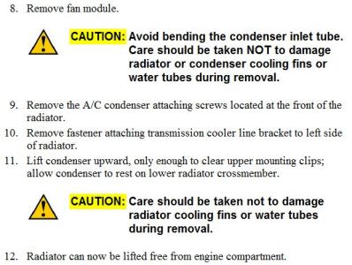

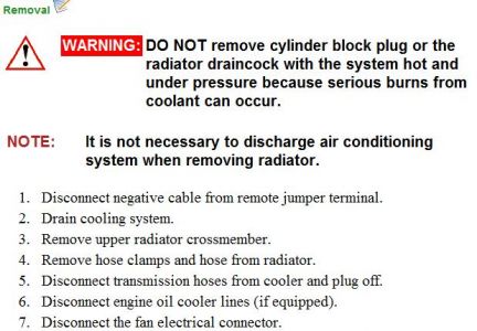

do i need to take the front of the car apart to get the radiator away from car.
May 3, 2009 at 4:35 AM
ZACKMAN
  • 4,202 POSTS
Nope.
https://images.2carpros.com/forum/automotive_pictures/55316_01intrepidradiator_1.jpg
https://images.2carpros.com/forum/automotive_pictures/55316_01intrepidradiator2_1.jpg
