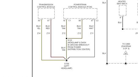

this is a car has some wires chewed by mice and it has no spark. also I noticed that the asd relay is not functioning properly, there is not a strong ground signal coming out of the pcm to the asd?

Check the PCM ground point -see below
https://images.2carpros.com/forum/automotive_pictures/12900_ground_PCM_1.jpg
