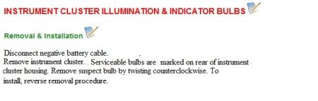

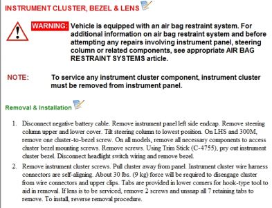

Replacement of Dashboard Lights for Fuel & Tach
Friday, March 12th, 2010 AT 9:26 PM
BLUELIGHTNIN6
MECHANIC
16,542 POSTS
SPONSORED LINKS
Friday, March 12th, 2010 AT 9:38 PM
