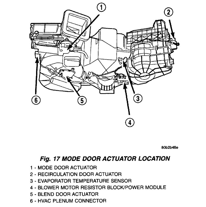

I have changed the two fuses for the hi/lo fans. I don't know what else to do. It is still blowing hot air when I set it to cool air. What do I do???
-Marco
Sep 8, 2009 at 9:02 AM
  • 75,992 POSTS
This sounds like the temperature blend door actuator is not working here is a guide to help you see what you are in for when doing the job and diagrams to show you the location for your car below.
this guide can help as well
Cheers
Sep 8, 2009 at 9:05 AM
BAALKE1
Thanks for the guides. I fixed my car for $56.00 for the actuator. :)

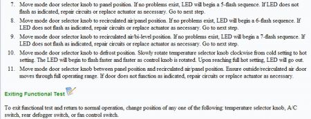

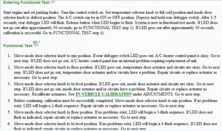

hi i recently lost my a/c in the car i had it on and it was running fine but it got cool that night and turned on the heat when i came to put the a/c back on the next day their was only heat coming out and hot just like the heater. I changed the hole heat and a/c unit and it was not that and the freon is full but now im trying to find the flap or flaps that might be jamed or malfunctionning. Could u help me out in telling me what the problem could be and were to find those traps that would open and close my hole dash is apart and its a real pain in the ... thank you very much
Aug 6, 2018 at 8:49 AM (Merged)
MERLIN2021
  • 17,250 POSTS
Do a function test like this and it will tell you where the problem is!
https://images.2carpros.com/forum/automotive_pictures/62217_AC_Test_1.jpg
https://images.2carpros.com/forum/automotive_pictures/62217_AC_Testa_1.jpg
