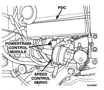

Where is the Engine control computer located on the car? Also, when it is replaced does the new have to have anything special done or can it just be hooked up?

The new PCM should be reflashed.See diagram below for PCM location. Check out the diagrams (Below). Please let us know if you need anything else to get the problem fixed.
