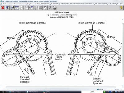

I'm replacing the timing chain on my intrepid (110,000) and need to know where to align the timing marks to re-set the timing?

I don't have a diagram for the crank but set the #1 piston at TDC on compression stroke, the crank mark usually points striaght up then set the intake and exhuast cams this way....
