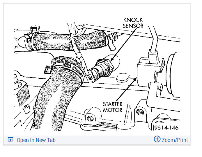

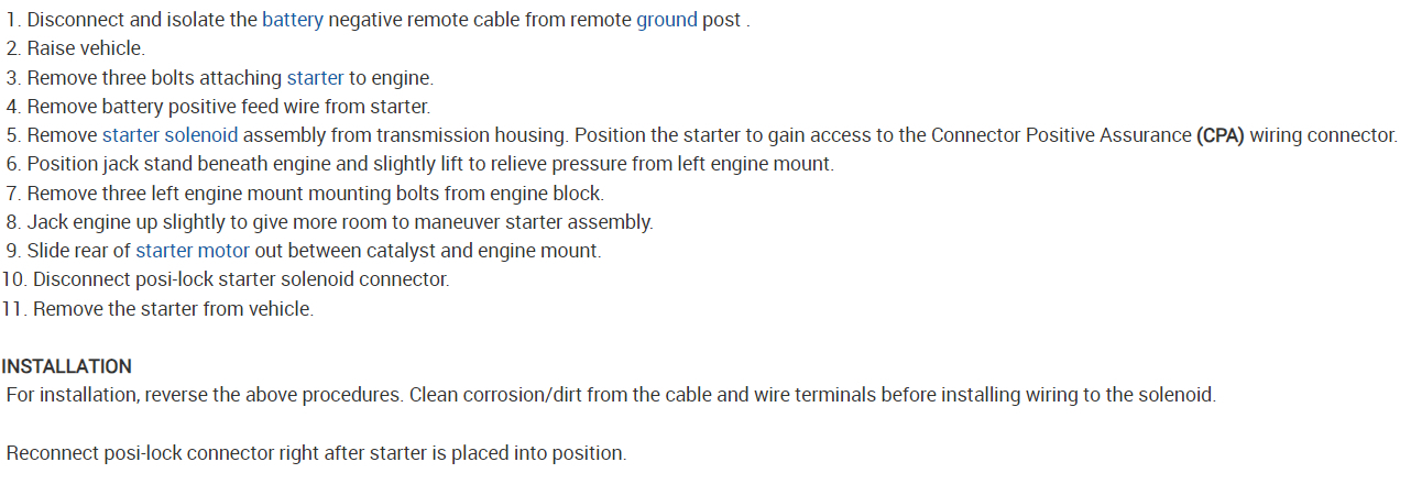

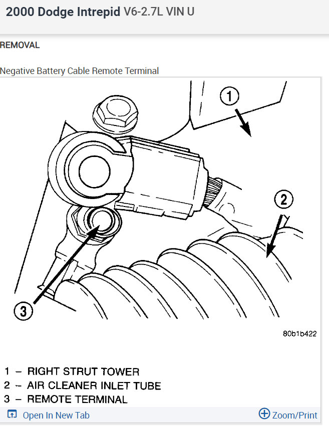

  • 55,746 POSTS
Also, I have seen the starter motor do this, I would swap it out to help fix the problem, here is how. Check out the images (below). Please let us know what happens.
