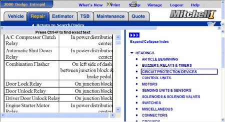

I am trying to find the location of the turn signal flasher.I`m getting many conflicting answers. Please help Thank you

Combo flasher location
https://images.2carpros.com/forum/automotive_pictures/12900_flasher_30.jpg

Mitchell books are ok.But they want 11.99 to let me know where its at is a little overkill.Someone must know where its at without costing me the price of the flasher. Thanks
