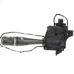

I have asked this question to you guys before and you responded that it might be the light flasher signal.
I have bought the Light Signal Flasher and installed it into my vehicle, but that didn't solved the issue. It's still having problems with the signal lights.
(Here is the problem)
Everytime I try to do my turn signals or used my emergency signal, it turn on for couple times then, it stops. Sometimes it doesn't even comes on, but there are times it does.
Would there be any other solution for me to check it out? I've already tried the turn signal flasher and replaced it. What would be the next step for me to check out? I've also check all the fuse and they are all in good condition as well.
Please help and Thanks

Hello sebastian_personal The combination switch is defective and must be replaced to take care of the problem. Air bag must be removed(be careful)and the three clockspring screws must also be removed.

Hello sebastian_personal I believe Auto zone do have this part($133.99),also dodge dealer or a junk yard . I advice dealer or auto zone because with junkyard, you do not know what you get. When working in the vicinity of the air bag,it is important to be careful depending on your mechanical skills. combination switch removal The Air Bag system must be disarmed before repair and/or removal of any component in its immediate area including the air bag itself. Failure to do so may cause accidental deployment of the air bag, resulting in unnecessary system repairs and/or personal injury or death. Disconnect the negative battery cable and isolate the cable using an appropriate insulator (wrap with quality electrical tape). Allow the system capacitor to discharge for 2 minutes before starting any repair on any air bag system or related components. This will disable the air bag system. # position the front wheels straight-ahead. # Fully extend or pull out adjustable steering column. # Remove the airbag # Remove the three clockspring screws. Carefully pull straight up on clockspring to remove. After the clockspring is removed, there is only one more screw on the top side of the SCCM that needs to be removed and is located at approximately the six o'clock position on the SCCM. It holds the lower side of the steering angle sensor, the lower side of the electric tilt lever assembly, or the strengthening strut if not equipped with electric tilt. # If equipped with ESP, remove the steering angle sensor screw located at the six o'clock position on the SCCM and remove the steering angle sensor from the SCCM. If not equipped with ESP, there will be a plastic insert there for strengthening of the SCCM that will lift right out. # If equipped with manual telescoping column, remove the strut screw, located at the six o'clock position, and strut. # If equipped with electronic telescoping column, remove the one remaining screw to electric tilt located at the six o'clock position, and remove stalk and switch. # Remove the speed control switch. # Remove the steering column tilt/telescoping lever screw located at the six o'clock position. # Remove the three screws from the bottom of the SCCM for the multi-function switch and Steering Control Module (SCM). # Separate the multi-function switch from the SCM.
