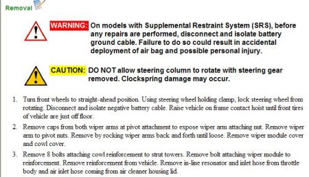

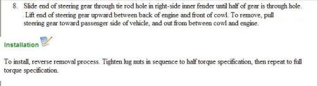

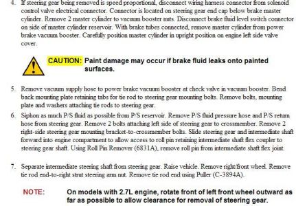

Would like to know difficulty and procedure for putting in a steering rack for my Dodge Intrepid? Was quoted over $1,000 to repair and cars value is about $2,000. It is either try and fix myself or unload.
Dec 1, 2009 at 4:37 PM
BLUELIGHTNIN6
  • 16,542 POSTS
this isn't a job for an amateur mechanic and requires the use of some special tools. replacement steps are below for you to read over and decide if you can tackle the repair or not..
