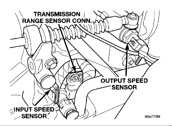

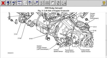

I am trying to located where the speed sensor is located..i need a systematic pict to find the location of the sensor...Autozone said it is on the transmission somewhere??? mk
Aug 15, 2010 at 5:12 AM
  • 75,992 POSTS
On left side of transaxle case.
