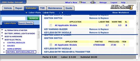

My 2000 Intrepid was stolen this weekend. It was found many miles away with the ignition broken (a screwdriver was used to start it). Can you tell me what would need to be replace? And an approx cost?? THANK YOU.

See below
