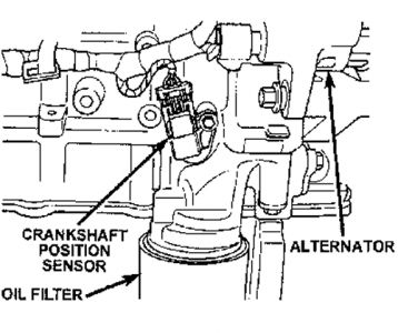

What does it mean? (Perform a CKP and CMP Sensor relearn with the scan tool) and (Tone wheel or pulse ring is damaged) answer if the crankshaft is bad and changed you will need a spesial scan tool so the new ckp can relearn. ( autoshop or dealer have that)so is the camshaft position sensor too. this is for the first code. To test this sensor, you will need the use of an oscilloscope. Visually check the connector, making sure it is attached properly and that all of the terminals are straight, tight and free of corrosion. Also inspect flywheel (6-cylinder) for damage, and replace if necessary. The output voltage of a properly operating crankshaft position sensor switches from high (5.0 volts) to low (0.3 volts). By connecting an oscilloscope to the sensor output circuit, you can view the square wave pattern produced by the voltage swing
https://images.2carpros.com/forum/automotive_pictures/46384_crankshaft_position_sensor_1.jpg
LFAN radiator relay is just a relay for the radiator left fan, located on the left side near the battery. the best way to test a relay if you do not have a multimeter is to replace it with a good one. The camshaft position sensor is mounted to the top of the timing case cover. The bottom of the sensor is positioned above the camshaft sprocket. try to change the crankshasft position sensor. do one ting at the time., because there are 3 big codes, it is good to start with the most likely of the driveability problem you presented.

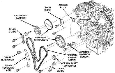

try to change the crankshasft position sensor. do one ting at the time., because there are 3 big codes, it is good to start with the most likely of the driveability problem you presented.s
Oct 15, 2009 at 1:41 PM
MATHIASO
  • 1,209 POSTS
https://images.2carpros.com/forum/automotive_pictures/46384_cam_1.jpg
There more than one code on your vehicle, I was saying to deal with one issue at the time. hope you can see the camshaft position sensor and the bolt that hold it to the engine block. it will need to be disconnected first.
