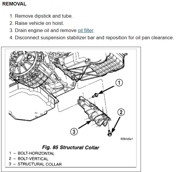

How do you change an oil pump in a 2000 Dodge Intrepid, 2.7L, 6-cyl
Nov 10, 2009 at 6:56 AM
  • 110,241 POSTS

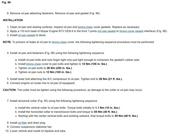

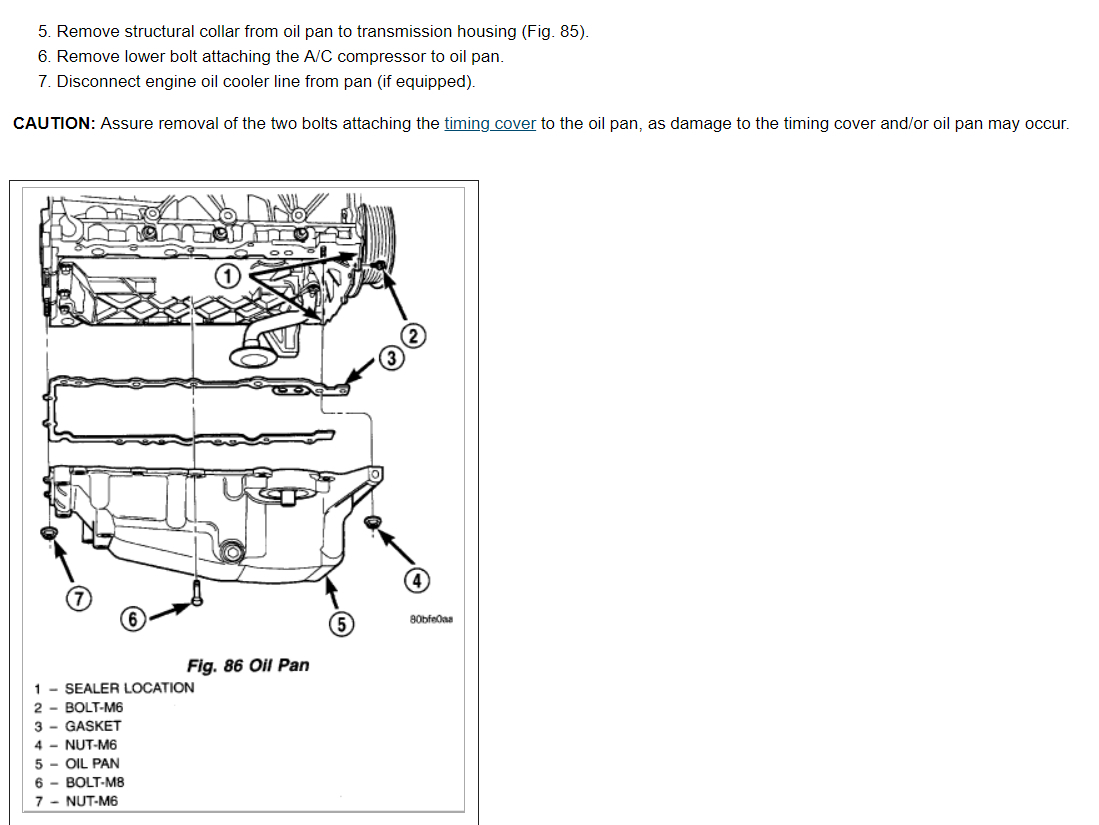

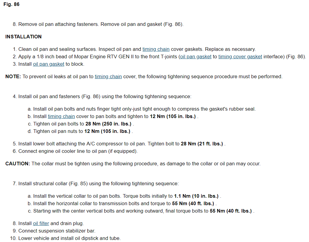

You will need to drain the oil pan. On this car, you will most likely need to lift the engine a few inches to actually be able to remove the pump. Once the pan is off, there are only a couple bolts holding it on. Make sure to drain the oil before removing the pan.
Here are diagrams to help you see what you are in for when doing the job
Cheers
