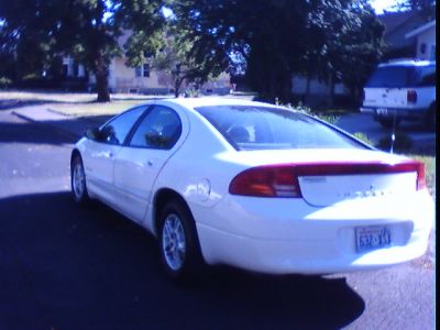

i have a 1999 dodge intrepid and its pouring out antifreeze from the middle of the engine. we took it inot a shop they said the thermostat housing needed to be replaced, then they found out the water pump does too. they said they would have to take the whole front end off to get to it cause its hidden in the car. how much do you think this will cost us to get fixed? those people arent even sure.[img:934ece8ea4]http://www.2carpros.com/forum/automotive_pictures/215261_pic070908_2_1.jpg[/img:934ece8ea4]
