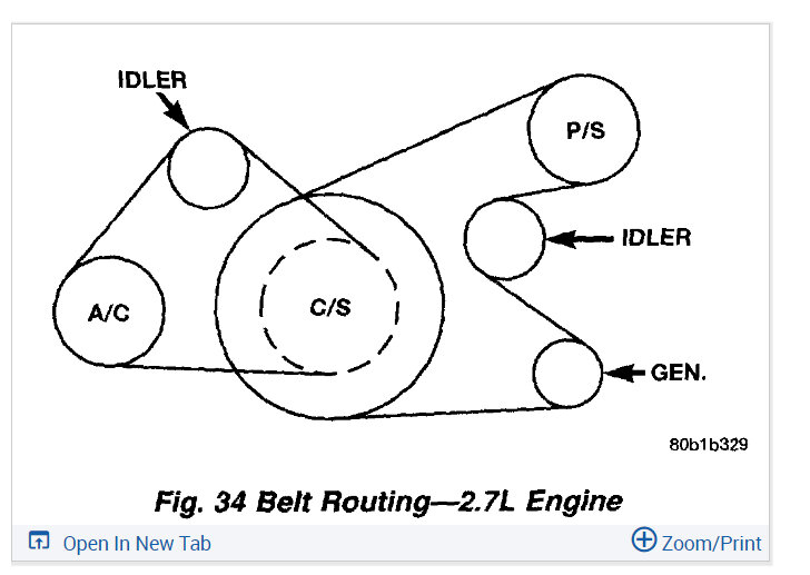

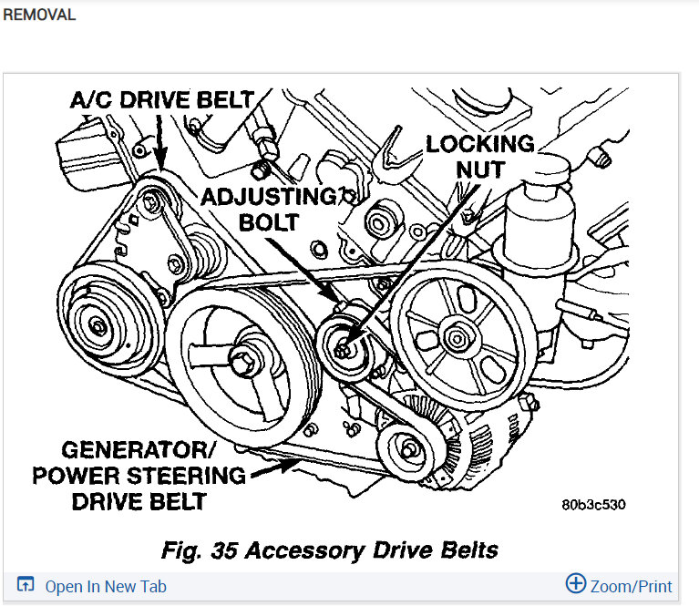

Hello everyone,
I have a 99 Dodge Intrepid with 128000 miles on it and there is a squeaky(chirping like) noise coming from the front of the engine, in particualr by the power stearing/alternator area. It does it when I start the car in the morning and once it runs hot it stops. However if the engine cools off for 2 hrs it comes back again. I thought it was the serpentine belt so I changed both belts and the idler pulley. The noise is still there. I went to mechanic and he said that it's the belts but that's normal considering the weather conditions in FLorida so he recommended spraying some WD40 when they squeak. I tried and it doesn't help. Any suggestions?

dont use wd40 try using some good belt dressing. if nothing you may have a bad bearing on the pulley.
Dec 7, 2007 at 12:13 PM
  • 55,628 POSTS

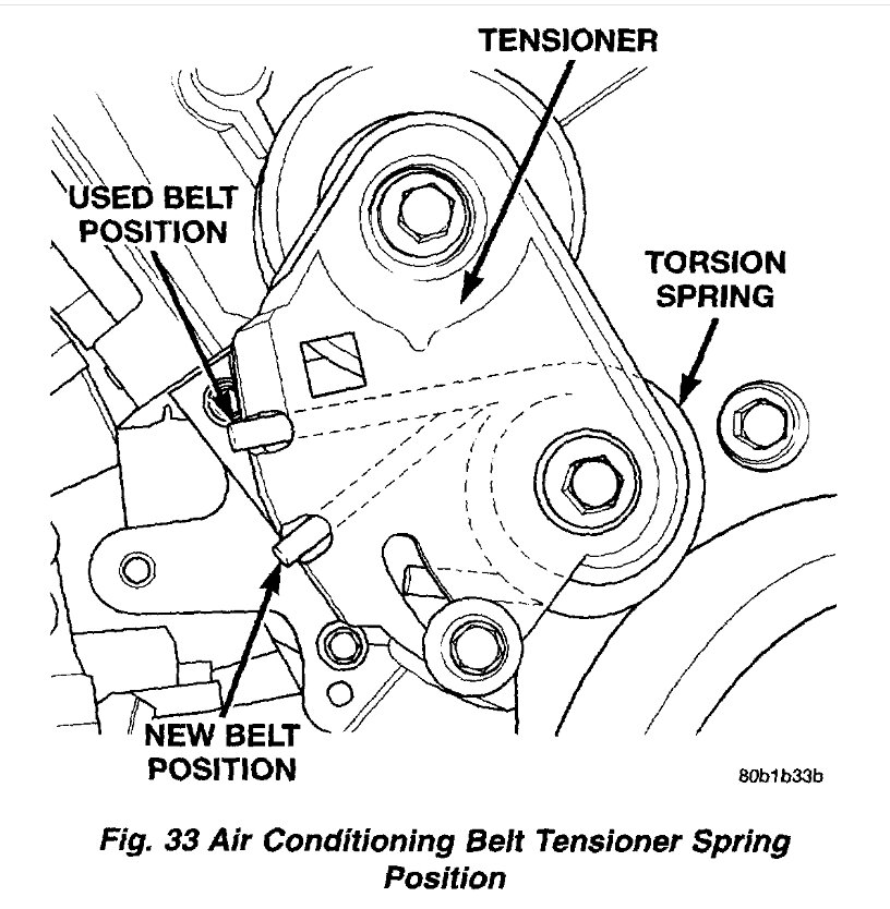

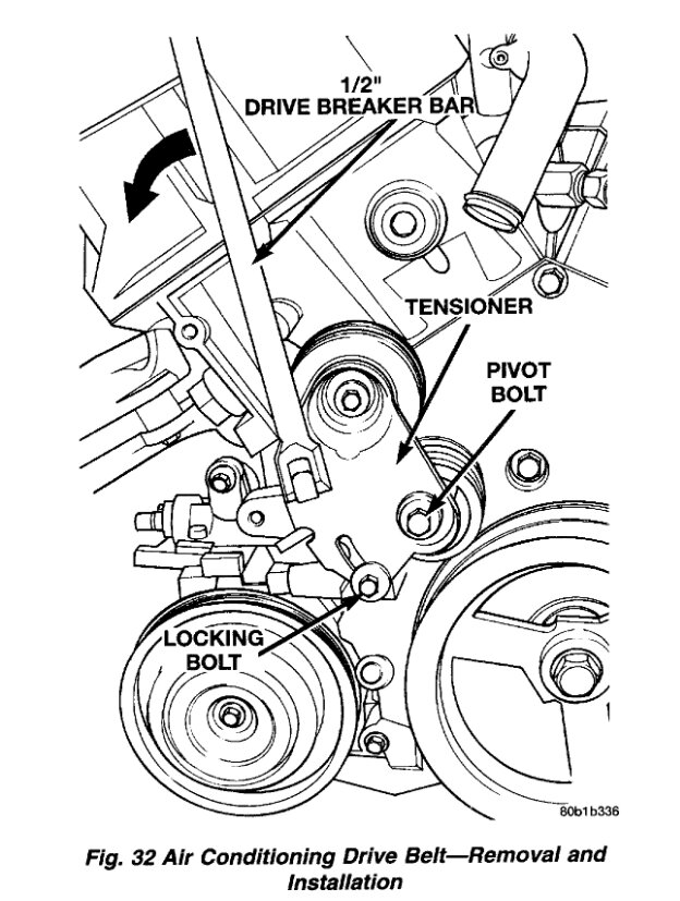

It sounds like you have a belt tensioner bearing going out, I would remove eh belts and spin the pulleys to see which one makes noise, here is how to change the belt tensioner out in case I am correct. Check out the images (below). Let us know how it goes
