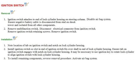

Need to know how to take out and replace the key switch

https://images.2carpros.com/forum/automotive_pictures/261618_Noname_2666.jpg
