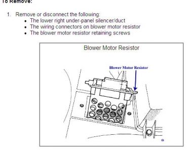

The fan only blows at high. What are the probable causes?

Welcome to the forum, I'd check the blower motor resistor assembly.
https://images.2carpros.com/forum/automotive_pictures/170934_intrigue_blower_resistor_1.jpg
