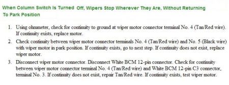

I have a 98 Dodge Intrepid with 80,000 miles. The windshield wipers do not always turn off in the down position. Is this wiper motor or switch? How can you tell?

https://images.2carpros.com/forum/automotive_pictures/261618_Noname_1038.jpg
