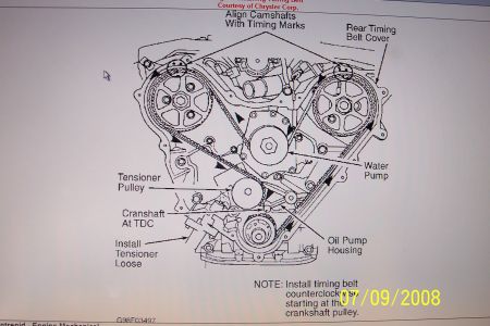

1998 Dodge Intrepid Timing marks 3.2
125,000 MILES • 6 CYL • 2WD • AUTOMATIC
REBUCK
I need to find timing marks on 3.2 to install new timing belt. I t is all out of wack, and do I need to do anything else after lining up all three timing marks to install the new belt, I already changed water pump. Any help greatly appreciated. Thans, Rick
Jul 9, 2008 at 1:53 PM
OBXAUTOMEDIC
  • 3,715 POSTS
Here are the Timing Marks......
https://images.2carpros.com/forum/automotive_pictures/188069_100_2507_1.jpg
