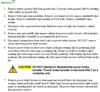

every time i brake theres a hissing sound and it gets hard to brake. i did some research and came to the comclusion that it was my power brake booster. i just dont know how to replace it
