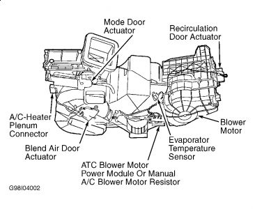

i have changed the thermostat. I bled the the system and no air is coming out of the bleed valve. the hoses to the heater core are hot on the inlet and return. when i turn the knob to go from defrost to the right and other funtions to the left the air blows out of the proper vents. I do not get the heat to get hot or the a/c get cold out of any of the vents. The only thing I have not checked is if the blend door is working. I do not have a good manual to even see where it is, if there is more than one, if there are sensors that can be checked. I am stumped at this point. I could use any advice on what it could be and directions and even pictures and diagrams in showing how to fix the problem.

Possible faulty Blend door actuator see diagram. If no movement but power then actuator faulty. Hope this helps Thanks for
