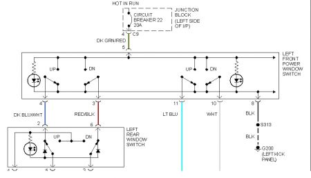

blower wont come on for heat and windows button wont work and air bag lite stays on when i try to turn heat on
Nov 3, 2010 at 5:57 AM
JDL
  • 16,098 POSTS
Use a voltage tester at the applicable fuses, check for voltage at the fuse, key on. If no voltage, you may have to check feed to and from the ignition switch. I'm talking about the power windows and blower motor.
