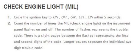

I WOULD LIKE TO KNOW HOW TO GET MY CAR STARTED I BELIVE ITS A PRBLOEM WITH THE CURRANT THE RUNS FROM THE CAR TO THE IGNITION COIL AND I WANT TO KNOW HOW THE COMPUTER SYSTEM ON THE CAR WORKS IF U CAN ASSIST IT WOULD BE APRECIATED

Hello, you might check for codes.
https://images.2carpros.com/forum/automotive_pictures/170934_dodge_intrepid_1.jpg
The dark green wire with orange stripe at the coil pack, should be hot with engine cranking. That voltage comes from the asd relay, that relay also supplies voltage to the 02 sensors and injectors. You might unplug the 02 sensors see if primary voltage to the coil pack returns? If the computer doesn't see the proper cam and crank signals, it may not ground the asd relay. No ground at the relay, engine cranking, no voltage on those circuits.
