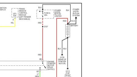

I dont know which wires to put onto the battery prongs without frying the battery. Theres 5 differnt wires and when I put them on how I thought they went on theres no power to the car. But when I change them up they get real hot and start smoking! Help
Sunday, March 30th, 2008 AT 5:24 PM
  • 75,992 POSTS
You got 3 black wires 1 red wire -the other one goes to the power distribution box which is gonna be a hot circuit-
Its getting hot bcuz you are mixing a hot and ground wire.
You need to do a continuity test on the black wires to determine what black wire goes to ground-see below
https://www.2carpros.com/forum/automotive_pictures/12900_batter_wires_1.jpg
HTH
