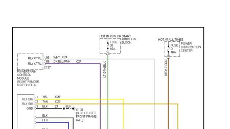

1996 Dodge Intrepid Two Wheel Drive Automatic 87000 miles
Engine overheats when standing in traffic. Neither the radiator or A/C fan is operating though the compressor is engaging. Common point appears to be RFI module between fans.
appears to be plugged in properly. Any suggestions?

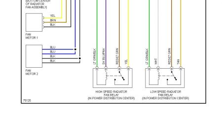

Check the coolant temperature gauge switch and engine coolant temperature sensor-the computer takes their input signals to activate the fan thru the relays/RF module
See below cooling fan circuitry
