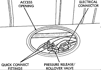

i need a layout of how to take my fuel pump out and reinstall it thanks

Remove trunk liner.
Fuel Pump Access Panel
https://www.2carpros.com/forum/automotive_pictures/12900_fpd_1.gif
Remove access panel fasteners.
Remove access panel and gasket.

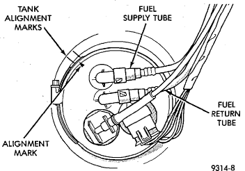

Fuel Pump Alignment

Disconnect electrical connector from fuel pump module.
Disconnect Fuel supply and return hoses from fuel pump module.
Disconnect hose from pressure relief/rollover valve.
Loosen band clamp until fuel pump module can be lifted from tank.
Place shop towels around fuel tank opening to absorb any spilled fuel.
Tilt fuel pump module to one side so fuel level sensor will clear tank. Allow fuel to drain from module before removing completely from fuel tank.
Remove fuel pump module and gasket from tank.
Drain remainder of fuel from module before servicing.
INSTALLATION
Position the new gasket on the fuel module flange.
Lower the pump/sending unit into the fuel tank.
Fuel Pump Level Sensor Diagnosis
https://www.2carpros.com/forum/automotive_pictures/12900_fpd2_1.gif
Rotate module so that the arrow aligns with the corresponding marks on the fuel tank.
Push module down to compress the spring, install the band clamp and tighten.
NOTE: Make sure that O-ring does not slip out of fuel tank lip.
